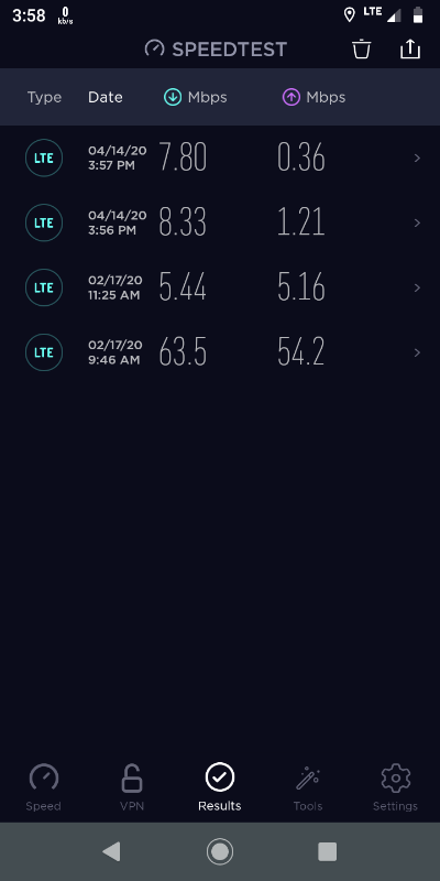

Wow, that's pretty bad. My download speeds have been normal for my area. Attached are some readings all using the Moto e6 on Visible. The two readings for February were one with the hotspot enabled (5 megabit cap) and the other without (Tampa Bay area) Now, the upload has been rather low inside the house. Thankfully, I have not have to use the hotspot for work purposes. Hope it all works out for you!
