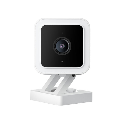

Wyze cameras are an excellent value ~$20/each.

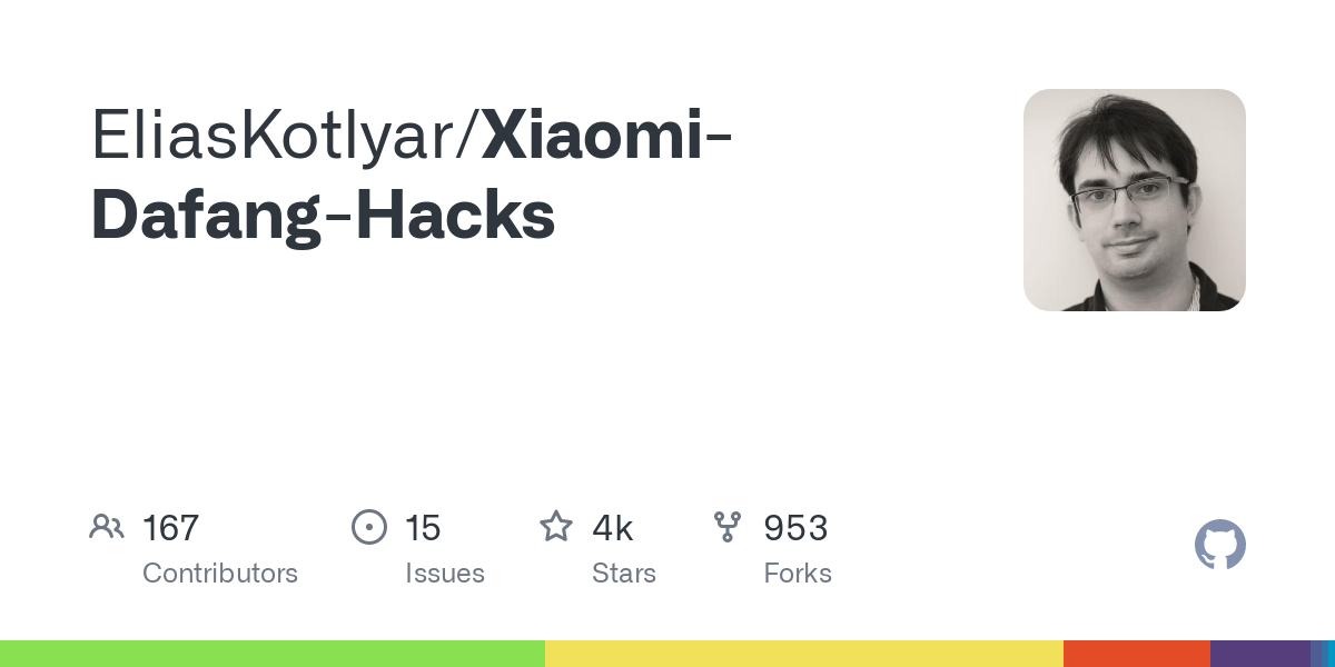

There is a third-party Linux-based firmware that can be used:
I use the third-party firmware on my Wyze cameras as I don't want or need the cloud features.
VLC or any ip camera surveillance software/app that supports RTSP streams can be used.
Wyze cams are decent for the price. They have an outdoor camera that costs $50 which is about as good as you can get for that price.

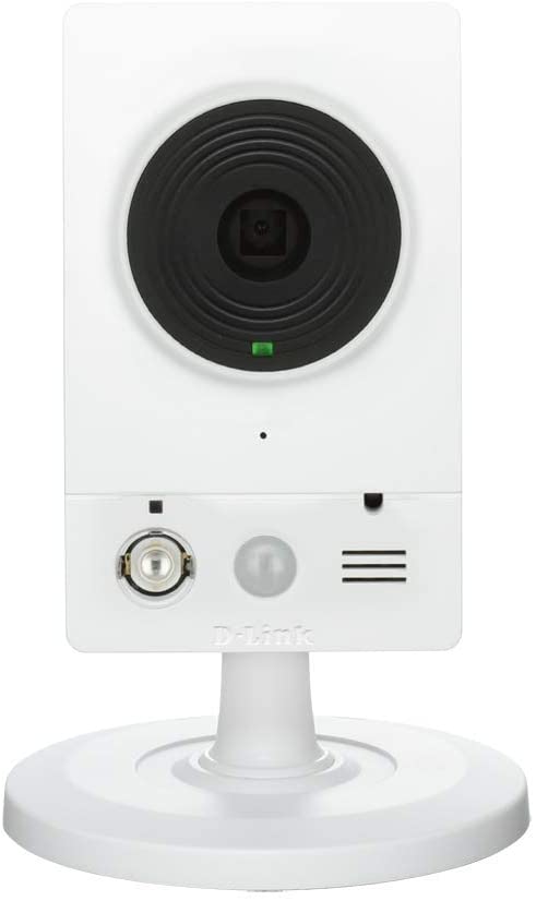

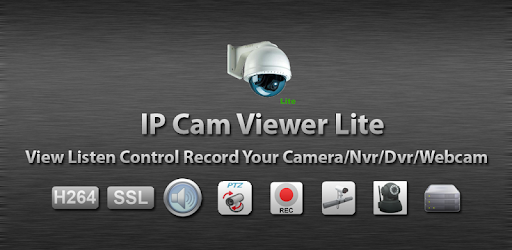

As it turns out, the el-cheapo D-Link cam also connects very well using an app called 'IP Cam Viewer' on a spare older phone I already had, and it is also nice to have it full-screened in landscape mode right where I can see it at my desk.
Even though the camera is a 2015 model & a bit of an oddball, it was only ~$12 & works via our wifi, plugged in so it is without any battery concerns & I've found that the older LG phone is 100% OK being plugged in to a USB charger 24/7 as well.
Another cool thing is that even our little, yellow tinted outside light is enough to get a really clear picture from this at night.
The extremely low cost for this has been its greatest attraction, what with other, similarly capable stuff costing multiples of what this all did.
All things considered, this project is now completed for me in a very satisfactory manner - MINUS the laview folks & their problems.
In case anyone else here has an older Android phone (or 2...) and wants to cobble together a really cheap surveillance rig, here is some added info which could take the place of some trial & error (what laview was for me)...
What I am using is a D-Link DCS-2132LB which was ~$12 when I got it - and is presently ~$18, here:
Great little camera, slightly challenging to set up - but works flawlessly with a strong wifi signal & this app:
IP Cam Viewer, from:
(It also has a paid version without ads...
https://play.google.com/store/apps/details?id=com.rcreations.WebCamViewerPaid )

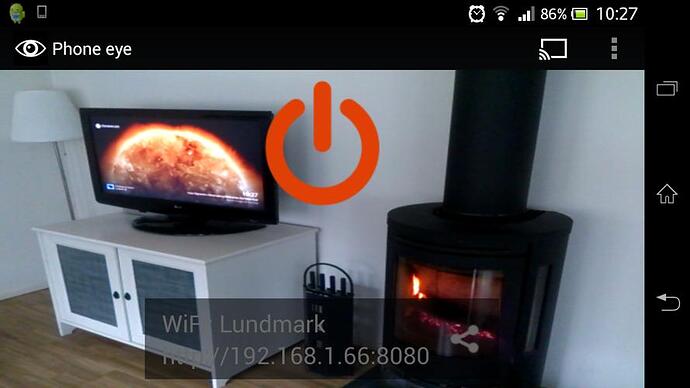

Another option that I tried was via an older (Kitkat) device with an added dollar tree wide angle lens clipped on as the source, with this app to broadcast it via wifi:
Phone eye Web camera (No longer at GPlay...)
Requires: Android 2.3.2+ (2015-02-25)
It worked superbly with only a browser for viewing on a 2nd older phone, but the 1st phone's camera did not do very well in the low light of our front porch at night.
